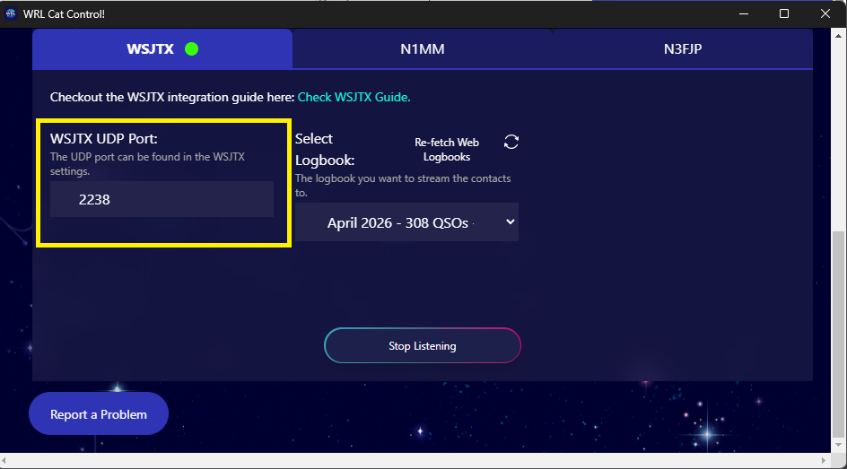

  2. Go to the settings icon (gear icon) and under the “Logger Integration Settings”, in the ‘WSJTX” tab enter port “2238” and select the WRL Logbook you would like the QSO’s to go into from the “Select Logbook” dropdown.

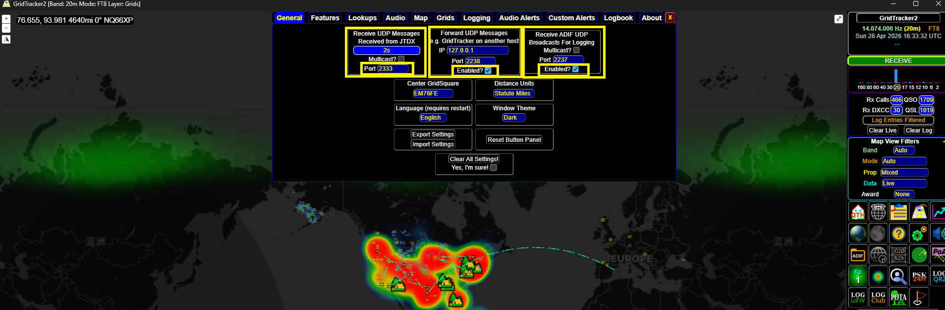

4. Open GridTracker Settings #
Make sure everything is set according to the screenshots below

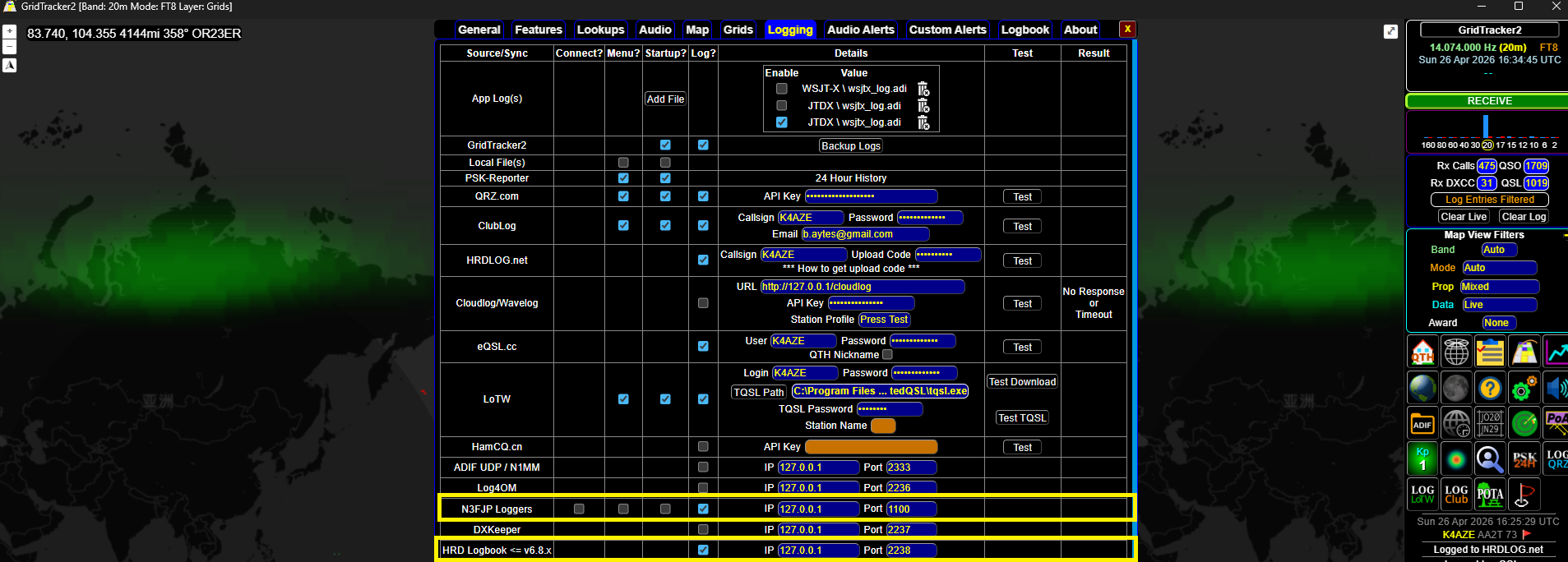

  1. Under the “General” settings tab set the UDP port ‘Receive UDP Messages” to “2333” & “Forward UDP Messages” to “2238”
2. Under the “Logging” settings tab set ONLY the “Log” column checkbox to enabled (checked) for the “N3FJP Loggers” and make sure the UDP port is set to 1100.
3. Under the “Logging” settings tab set the very last option “HRD Logbook” (we are using HRD Logbook since GridTracker doesn’t have a WRL option, currently) as enabled (check the ‘Log’ column) and set the UDP Port to “2238” *This is important*

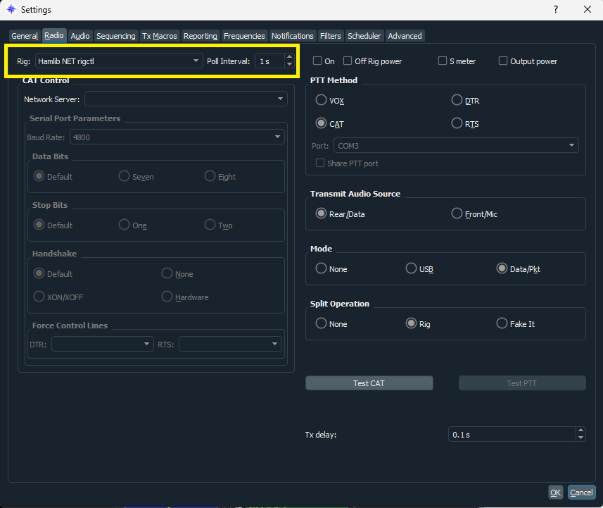

  1. In the WSJTX “Radio” settings tab, from the “Rig” drop down select “Hamlib NET rigctl” (if you are using the WRL Cat Control App for rig control, if you are not using the WRL Cat Control App for rig control, select your radio, Com Port, & Baud Rate settings)
    • From under the “PTT Method” section inside the “Radio” settings tab select “CAT”
    • From under the “Transmit Audio Source” section inside the “Radio” settings tab select “Rear/Data”
    • From under the “Mode” section inside the “Radio” settings tab select ” Data/Pkt”

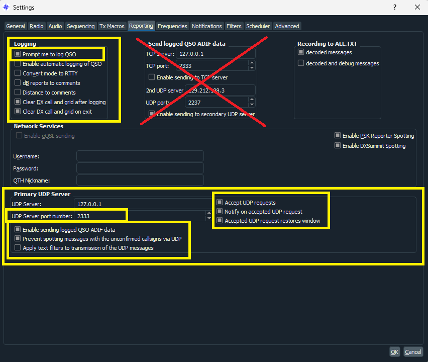

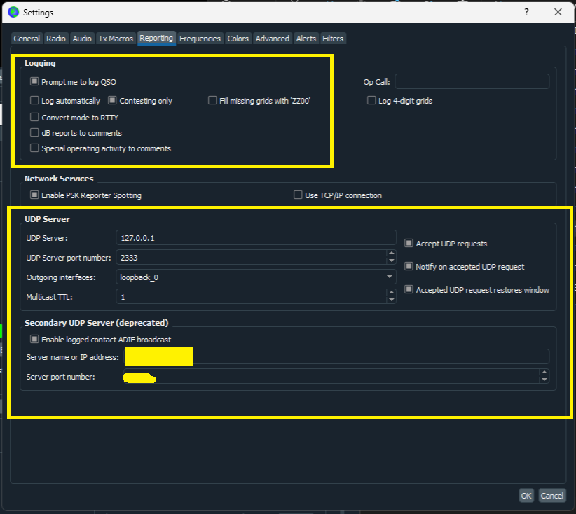

  2. In the WSJTX “Reporting” settings tab, in the “Logging” section enable “Prompt me to log QSO”
    • From under the “UDP Server” section inside the “Reporting” settings tab set the ‘UDP Server Port Number” to “2333”
    • From under the “UDP Server” section inside the “Reporting” settings tab enable the following:
      • “Accept UDP Requests”
      • “Notify on accepted UDP Request”
      • “Accepted UDP Request restores window”

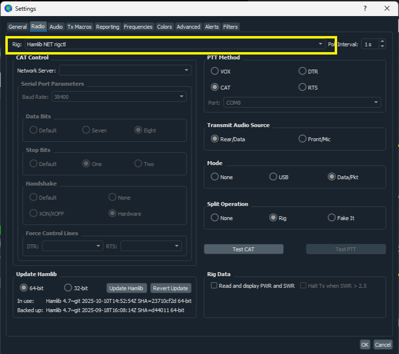

  1. In the JTDX “Radio” settings tab, from the “Rig” drop down select “Hamlib NET rigctl” (if you are using the WRL Cat Control App for rig control, if you are not using the WRL Cat Control App for rig control, select your radio, Com Port, & Baud Rate settings)
  2. In the JTDX “Reporting” settings tab, in the “Logging” section enable “Prompt me to log QSO”
    • From under the “Primary UDP Server” section inside the “Reporting” settings tab (at the bottom) set the “UDP Server Port Number” to “2333”
    • From under the “Primary UDP Server” section inside the “Reporting” settings tab enable the following:
      • “Enable sending logged QSO ADIF data”
      • “Prevent spotting messages with the unconfirmed callsigns via UDP”
*** The X’d out portion is not needed ***

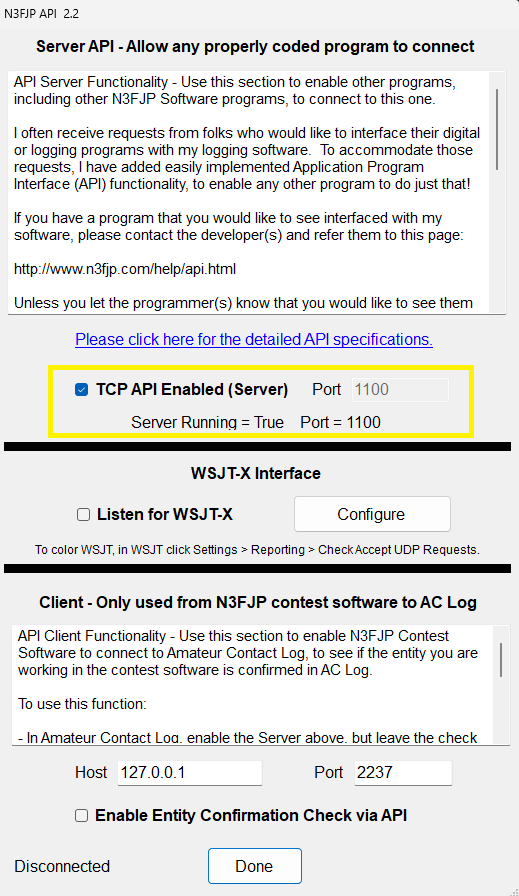

6. Open N3FJP #
  1. After setting up everything above you need to open N3FJP and
    1. Goto “Settings -> Application Programming Interface (API)”
    2. ONLY Enable “TCP API” and make sure it is set to port 1100
    3. You do NOT need to enable “Listen for WSJTX”

    1. Start WRL Cat Control & click ‘Start Radio Connection’ (if you’re using rig control), then click ‘Start WSJTX’ button (this wont actually open WSJTX or JTDX it will just start the UDP Listener.
